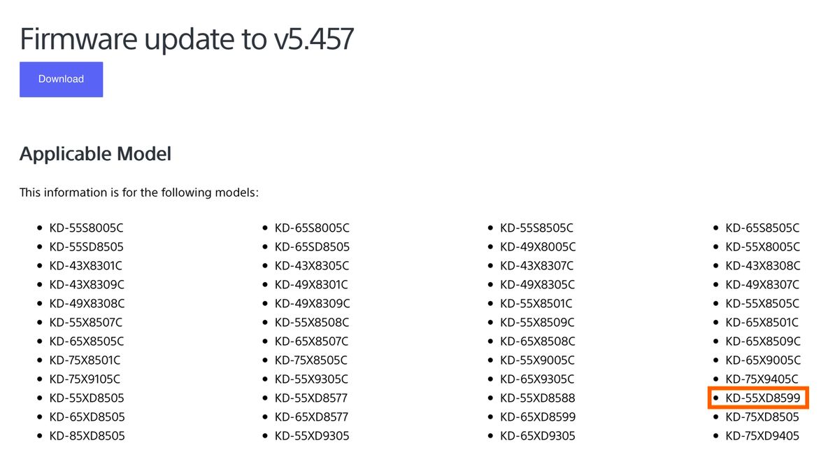

Firmware update to v5.457 | Sony UK

Your TV is included in that list if you click the View All Applicable models text you will see your TV model.
It is in the last column third from the bottom.
The link I posted earlier is a direct link to the downloads page for your model of TV the model number
of your TV is in the text of the link.
If you look at the very top of the page on the left you will see your TV model number.
You say your TV is up to date, are you sure as the version number you quoted earlier is lower
than the version available from the link I posted.
