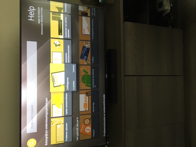

I tried your solution yesterday but i can not find it. Where can i clear the application data/cache? I pressed the "HELP" button on my remote control and i didn't find anything like you mentioned.
See attachment of what i am seeing after i pressed the HELP button. It is in dutch but maybe you reconize some things?Help.JPG

There should be the possibility to enter Settings from this menu. I haven't tried it myself. Here is another hint:
To access the settings, press the Help button, then under how to use your tv scroll to the end and select Settings. Then go to configuring -> TV -> Jump to settings.
It is the second row. At the end there should be the Settings menu. Inside you will find the Apps menu where you should find the System Software Update app.
