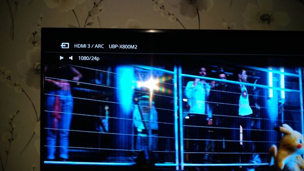

My Sony TV xg8396 has had a update
but when using my Sony 4K player x8000m2 the info bar keeps coming up on and off I have looked on sites and says to go to settings and then channel setup and then info bar I cannot find info bar on the settings anywhere on the TV any help

Not the only model having that issue. XG90 same issue with that firmware.

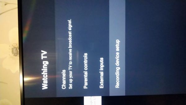

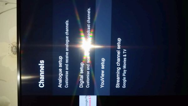

I have contacted Sony support and they advised that this being investigated by their engineers; however, as a workaround for now, you can disable the info banner by pressing home- select settings- watching TV and set the info banner to OFF
D-Law81
Member
Can't find info bar anywhere.

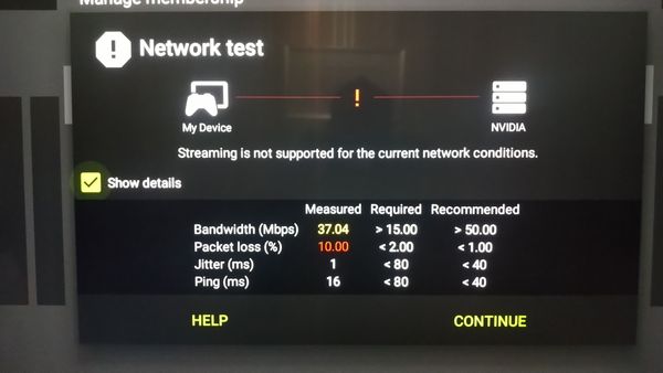

This may not be sony but I use Geforce NOW on My TV, but have seen I'm getting pocket loss to TV but I am wired with 200mbps Internet. Is this the TV or Nvidia.?.?

Is this in relation to the last software version?
Also, have you tried using WiFi instead of wired? If so, do you get the exact same results?

Yes this is due to the latest update never had these issues before.  would have to try wi-fi but all setup is connected wired meant to be the better option

That's very true, unless the wired port is rated at lower speeds than what WiFi is capable of.

This is a speed test off Netflix on the TV. Wired. We own the virgin media 200mbps broadband. All was fine before the upgrade/update. 😊
