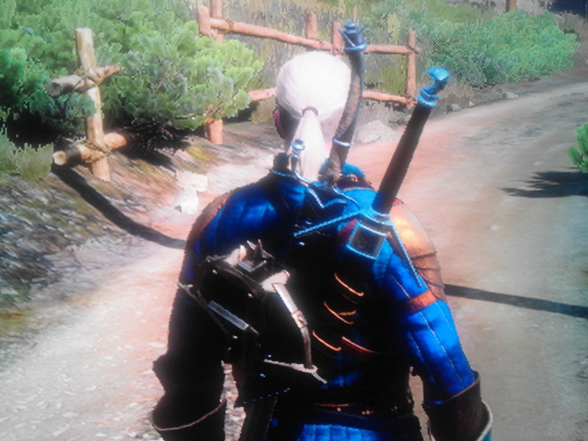

Thanks for the reply your KD-55XD8577 TV is a higher spec than mine which is a KD55XD8005BU though. But here is a screenshot I took from the game The Witcher 3 if you look around the outline of Geralts body there are jaggies all around him also on his sword I never had this problem with cheaper Sony TVs20160922_213932.jpg
xx4L0Mxx
Опытный
Have you tried turning down the "Sharpness"  setting? Turn it down too much and you will start to blur the image, but tuning it correctly is like adding free anti-aliasing for no performance hit.
