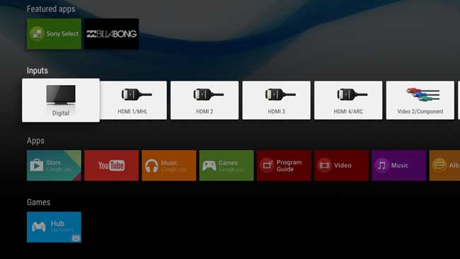

You can also press the [HOME] button on the remote control and on the home screen you should see the inputs to select:
