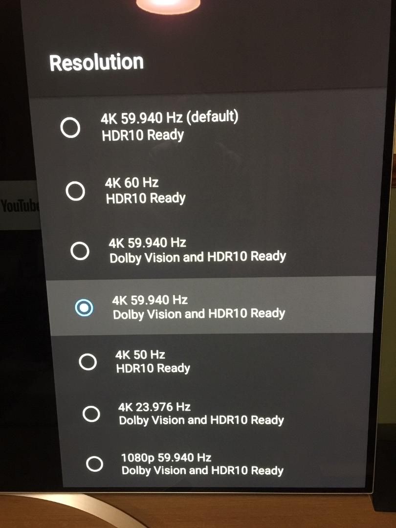

 the issue seems to be   between the tv and the nvidea shield. for some reason the  tv's/ HDMI's capabilities are not  detected correctly by the Nvidea  shield I'm going to  try another HDMI cable to see if its a comms  problem between the tv and the shield's HDMI ports. ive attached a  phot here to show what the dispthis is what it should look like if detected correctlythis is what it should look like if detected correctlylay settings on  a shield should look like if it  correctly detects te TV's display capabilities

 ok ive managed to  resolve this.
 apparently the formats shown in the screenshot which I  posted  only show if running sw version 18.1 which iswhy the newest devices see those listed older models like  mine wont show them w  till s/w version  18.1 is rolled out to the older devices. that will happen once  all the bugs in  in 18 have been  sorted out.
