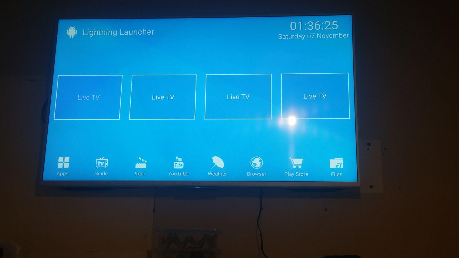

Hey all new around here i bought my TV model# KD49X8307C around december last year and i love it but i absolutely hate Leanback Launcher its just way to basic for me and not very customizable so the first thing i did was went to the extremely limited TV version of Google Play and looked for a new Launcher. IIRC i installed HALauncher anyways when i pressed the home button on my remote control a box popped up asking if i wanted to use the new launcher as my default i confirmed and was happily using the new launcher then i found out i could sideload apps so i sideloaded the launcher i was using on my Z5, which was lightning launcher and i was using this as my default for ages until Sony rolled out an update ever since that update i havent been able to set a default Launcher anymore when i press the homebutton it just takes me straight back to Leanback Launcher. I have been talking to Sony about it for a few months now but im starting to get the feeling like they dont believe me even though i can and did show them proof. Can anyone here confirm they could once set another launcher as a default? or can anyone still do it?

Thanks for the reply neither are Sony from the sounds of it lol heres the proof i sent them, it was the 2/2/2016 update that took the feature away.

I didnt because i know its nothing to do with the Launcher because no Launchers show the set default dialog anymore, yeah its been a while devs been busy implementing multi editing which is a massive complicated feature.Theres an update planned for this Monday though so il try it anyways but id be willing to bet my balls that it wont fix this. I know about the permissions app i wrote a script the other day that needs the launcher to have the SEND_SMS permission and the guy i wote it for had to use the permission manager app to grant that permission.but even if i could use that app it doesnt work standalone it needs Xposed framework and my TV isnt rooted.
I updated the app but still cant set as a default. I noticed on Launcher app description it says Android 6.0 cannot set as a default. IIRC Sonys 2K15 Android TVs are still running 5.1.1 which is Lollipop. So if Sony can fix this il be turning off the update feature and sticking with Lollipop.
