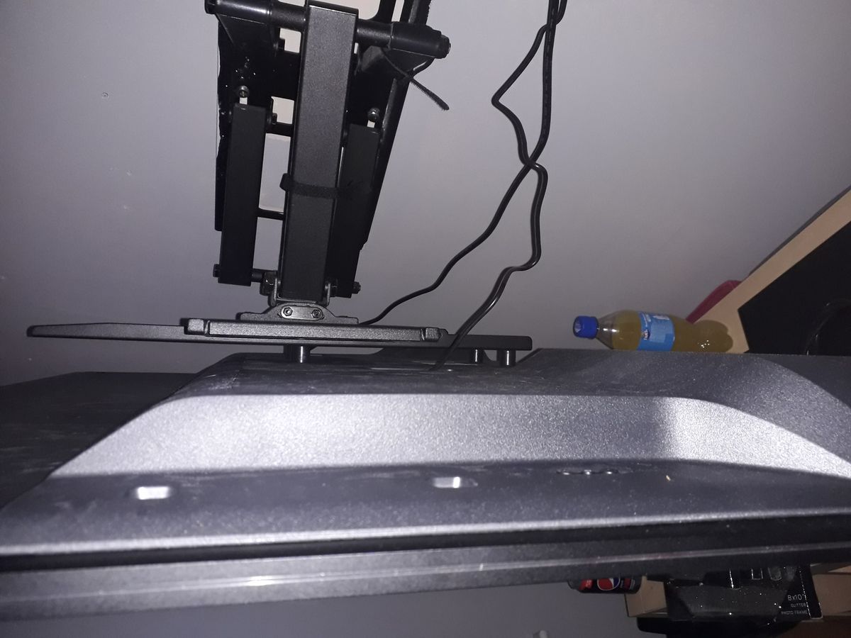

When my husband attached it to the bracket is didnt seem as sturdy as our previous telly did and when i googled the vesa measurements for my new telly i couldnt get a clear answer. I then contacted sony with the model no fromy tv and was told that no vesa bracket was suitable and there was no vesa adapter which would fit and i was given the product no for a sony bracket that i was advised was the only bracket that would fit my tv.
It is as i mentioned already on the bracket but im just not if i should be taking it down based on what i was told my the sony worker or is it safe once it fits.
Hello @Rachelaoife,
would you mind uploading an image (you can do this via the button above the text-window), which shows the back of the TV with the attached vesa mount?
It would help to judge, weather or not it is a viable way to mount the TV.
I assume the person you talked to on the phone is required to not recommend third party mounts, since then you as a customer could try to make Sony liable if the mount fails - with the argument "your rep on the phone told me it is safe to use".
I think that is the only reason he told you, you should use the official mount.

I hope these are clear enough nic thanks
Hi @Rachelaoife,
if the screws grip deep enough into the TVs threads and the TV doesn't move on the mount, I don't see any reason why this mount wouldn't be sufficient
