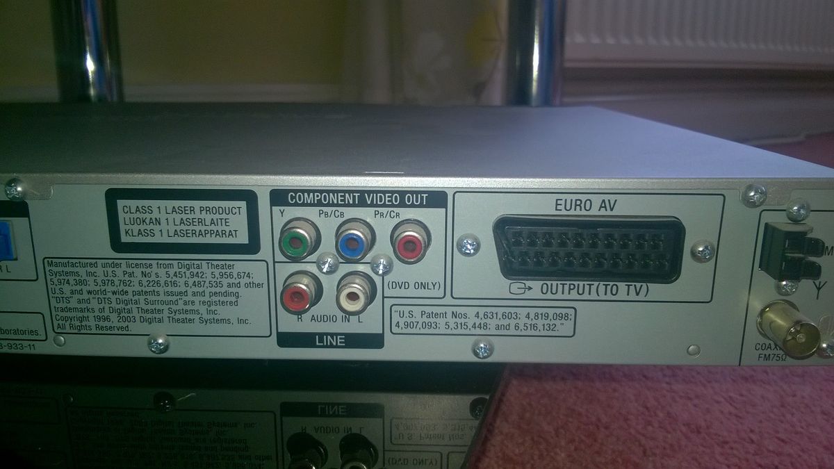

it's easy
does your tv has component in (red/green/blue)? if yes your DAV also have component out for video
if not, does your TV has RCA in (Yellow/white/red)? if yes, just buy a scart to RCA  cable

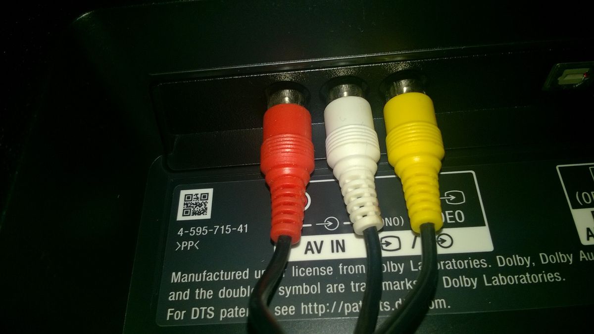

Hi Sonyvores,
Thanks for response. I have attached a couple of photos. The first is the DVD, the second the TV. From your message, I believe the TV has the RCS, so scart to RC should fix it?
Thanks
Sonyvores
Contributor
@BIS044
Thanks for taking time to take pictures, it's a much easier to be able to help you out.
So yes a scart to rca cable will do it. But since it's analog,  picture won't look the best on' your tv ^^ but at least you will be able watch your dvds 😃
BIS044
New
Thanks for your help, Sonyvores, appreciated!
