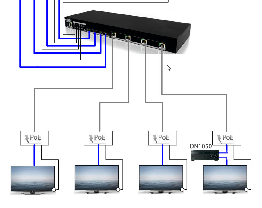

Good morning Poddy,
Thanks a lot for your feedback - think we're getting closer.
I assume that you want to playback the sound from your sources via STR-DN1050 as well. Therefore you need to connect the STR to the matrix using a HDMI cable.
If your Samsung TV is located in the lounge as well you can connect the STR to the HDBT receiver as follows:
But if you want to use the STR separately you need to add a fifth HDBT to your set-up in principle. Anyway, I'm not sure if the matrix can handle this since it has been built with 4 outputs only.
Therefore I would recommend the setup as shown in above picture.
Hope this helps
Have a great day
Cheers
Peter

Dear Peter,
Sorry for the delay in acknowledging your very welcome message! I am extremely grateful to you for your detailed reply and with a tremendous illustration to boot! Thank you....as you remarked we are getting closer, much closer to nailing it! Of course I am the weak link!! Ha Ha
You are correct - I do wish to play sound from all my 3 devices through the STR! I also agree with you the Matrix has only 4 outputs which could be seen as a limiting factor - given I haven't introduced a Sky Box or Apple TV - but no matter for now. The main thing is getting sound through my STR to my lounge in support of my 4K TV. Currently, great picture - shame about the sound!
Firstly Peter,are you suggesting I utilise the 'spare' HDMI input 4 on my Matrix ( see the hand drawing I sent you previously) and connect this to my STR? If so, which "Output" do you advise I use on the STR, One Output,Output B or Output A ARC? (Does it matter which one?) Or do I use an 'Input" HDMI on the STR, if so which one?
Secondly, in your diagram you refer to 4 x PoE. In this specific context are you referring to the HDBT Receivers or my Patch Panel Ports (48 Ports) or Internet Switch panel (16 Ports)?

Hi Poddy,
Thanks a lot for your reply and the additional picture,
Don't think you're the weak part :slight_smile: as this is not a standard everyday set-up.
You should connect the output of an HDBT Receiver (e.g. that one that goes to the Samsung TV if this TV is located in your lounge) to an input of the STR. Then connect the an output of the STR to the ARC HDMI input of your Samsung TV.
Doing so you should be able to hear the sound of all you sources and the connected TV via the STR in your lounge room.
Please let me know if it works.
Good luck
Peter
P.S. Regarding you last mail - no your sources should stay connected to the Atiference matrix.

Hi Poddy,
LOL - I really love your sense of humor :wink:
It's really fun writing to you.
Also thanks a lot for your patience with my broken English - unfortunately it's not my mother language.
I see your problem with the different locations but you need to disconnect the red HDMI cable from the TV an plug it into the STR input. Then you have to connect the STR output with the TV input. Doing so you should be able to hear the sound via the STR.
Plugging the STR into the spare input will not work as you can't connect input to input.
What's the distance between your comms cabinet and your TV? If the distance is too big we probably have to rethink the strategy as the maximum HDMI cable lenght will be 49 feet.

Good morning Poddy,
Oh well - that's what I've feared :S
First a bit about my backgrounds: I've studied radio and TV technics and worked in the Sony service in the beginning, later I move to technical marketing before I ended up in communities. So yes, there's a little bit of technical background :wink: Anyway, did not do thr programming for VW - lucky me :grin:
Using the ethernet on the STR is not an option as you won't be able to transfer the necessary information forth and back to the TV. And also moving the STR to your TV seems not to be the best option as it will ruin your house with several visible cables :grin:
So we need to find another way to transfer the HDMI signals from the HDBT receiver to the STR and back to your TV.
So here's probably a solution using some additional hardware in you Comms cabinet:
1. Remove the HDBT receiver from your Samsung TV an move it to the comms cabinet.
2. Use a short network cable and a HDMI cable to connect this HDBT receiver to your STR's HDMI input and to teh matrix output you've used before for your Samsung TV.
3. Use the transmitter of this set and connect it via HDMI to your STR's and the network cable to your Samsung TV.
4. Connect the receiver of this set to the other end of the network cable and then via HDMI to your Samsung TV's input.
Doing so it should work in the end. Anyway, there's one dis-advantage: You will not be able to control your Samsung TV via infrared remote signals - but of course you can control the STR (don't know if you use this function of the HDBT receivers).
Please let me know if this makes sense.
