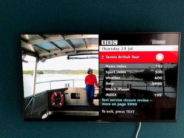

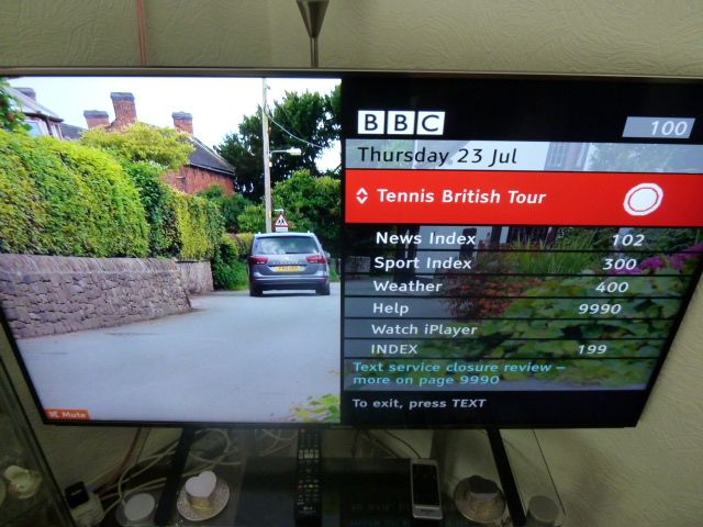

Hi Thanks again for your reply Please find attached a couple of images of page 100 on a panasonic tv on BBC 1 AND BBC2 channels.

Thanks for that Robert, you've cleared this one up. We are talking about different things. These pictures are not Teletext - they are Digital Text (the modern day version of it). Also known as Red Button Text because you can access it using the red button on your remote.
