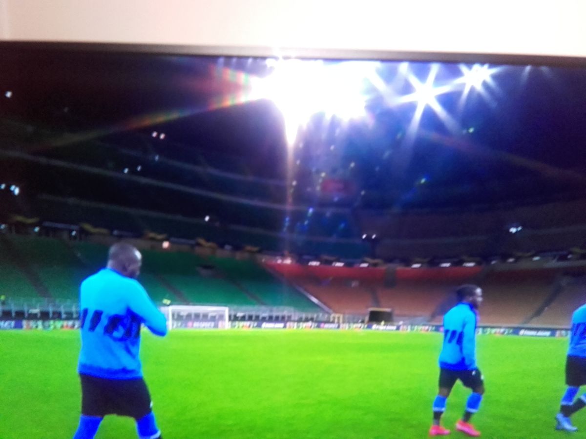

I finally got around to taking some photos of some of my issues.
I am seeing lots of light reflections within the content and it's seems very excessive? picture quality is very poor also at times.

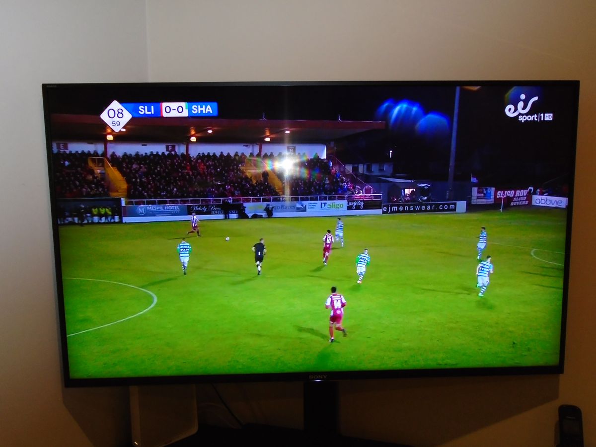

Flash in mid of screen is from my camera, ignore this. Blue shapes near station logo.
Octagon shapes appearing throughout screen.
Blue blur bottom left
lots of blur and streaks.

Nobody can say anything without knowing the source. I suppose the tv itsef cannot create octagone on the image i.e., nor the blur is always on the same part of the scene...
You should also let us know which setting are you using.
