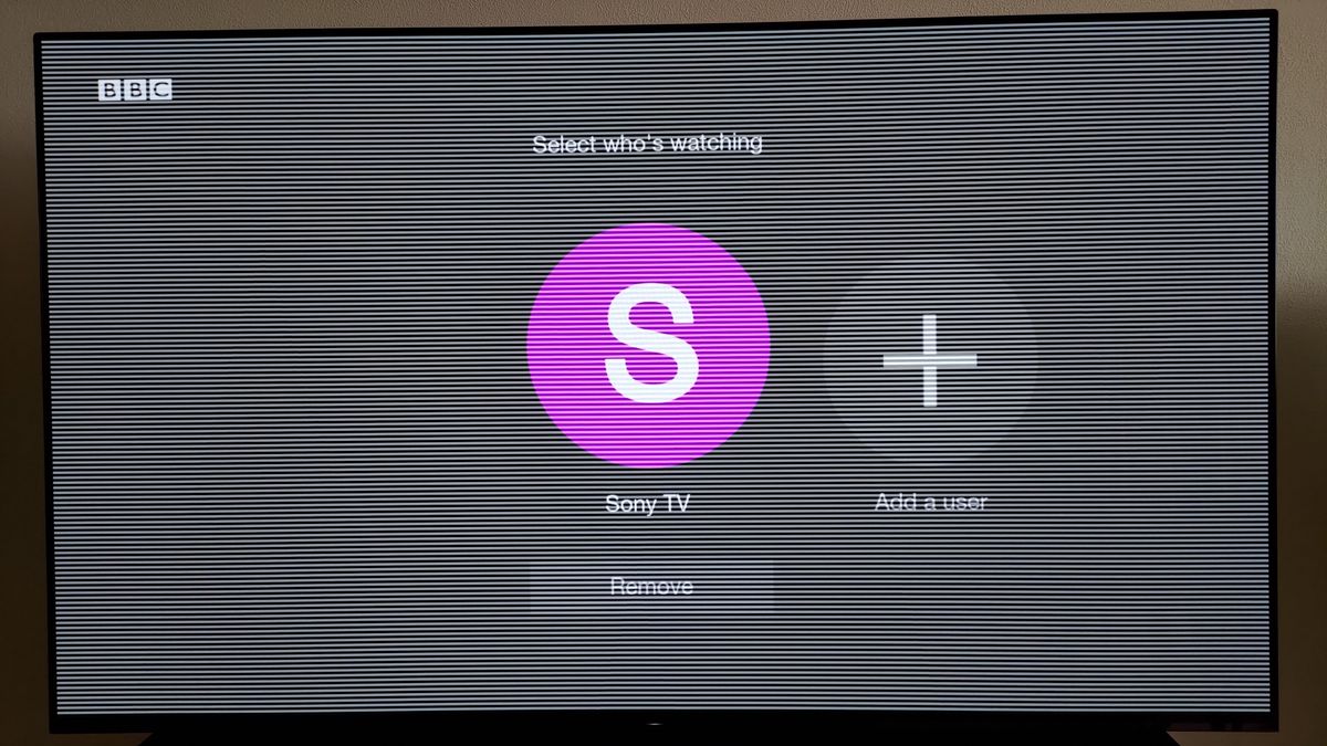

I'm having a problem with built-in BBC iPlayer app on my AF9 after the latest firmware update. As you can see in the attached pictures here, it suffers from these small horizontal lines making it unwatchable. The lines appear upon opening the app and disappear when app is closed.

Found the culprit. Turning off "Force GPU rendering" under "Developer Option" fixed the problem.
