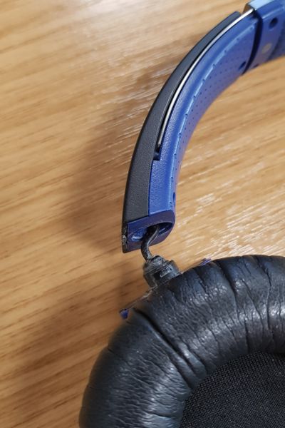

i've had my Headphone for a few months now and the headphones has broken on the left side, earphone connects to the headset via a small peice of plastic, does anyone know how i can get these repaired? i dont seem to be getting anywhere with getting it fixed under warranty

Exactly the same problem, left side. Everything else works just fine but they’re basically useless now. That swivel is weak, bad quality plastic and tiny. Easy to break after some time wearing them at home, I did't even took them with me anywhere else. It should be under any warranty...

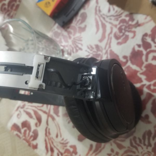

I'm an amateur when it comes to repairing electronics, but there is good news! After spending the day tinkering with my two sets of Sony MDR ZX770BN's I'm glad to say that I have managed to repair them after suffering the exact same issue as you.
On the inside of the headband, there are three Phillip's screws holding a plastic bracket just above the swivel mechanism (and just below the 'Left' and 'Right' icons) which connects to the wishbone. Undo those three screws to reveal the headband adjustment mechanism along with, in your case and mine, a lose piece of plastic shaped like a donut hangingosely off of the cable inside along with a loose metal plate shaped like the letter 'U'. Simply using a polymer glue, such as "Lockite", on the top part of the swivel piece and the underside of the plastic ring and let the glue cure. Once cured, place the metal plate shaped the letter 'U' in its bracket, which should slide in under your newly glued ring as this prevents that plate moving and allowing the swiveling action.
I hope this helps you as it helped me save another £75 on arguably some of the best value Bluetooth headphones around!
