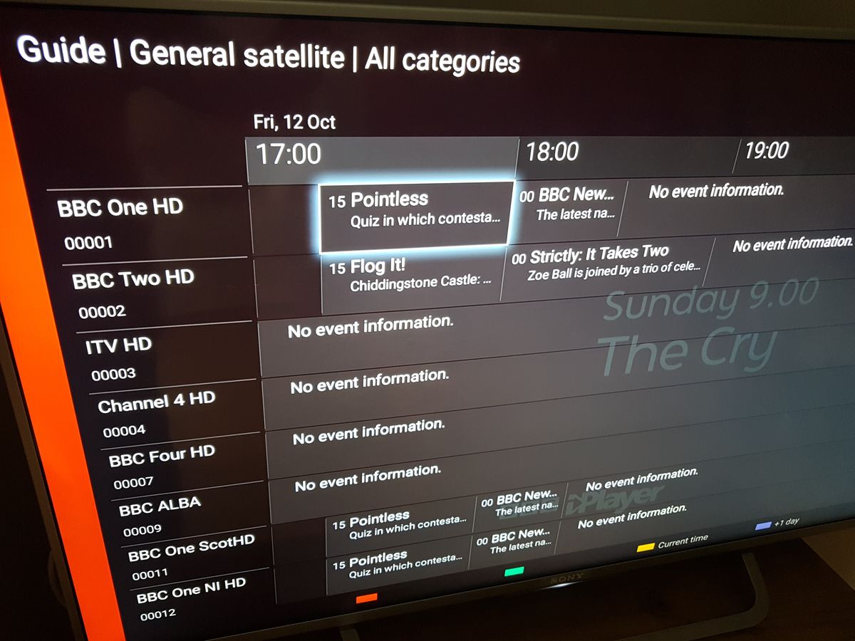

Lesson learned, it's Samsung for me next time out.

@orwell84 I just checked and you are spot on.
Sony are calling out this EPG as a "feature" on their website for my TV at https://www.sony.ie/electronics/televisions/xf8005-xf8096-series/specifications#features
Unbelievable.
I guess there is an EPG, it just doesn't contain any information!!!
